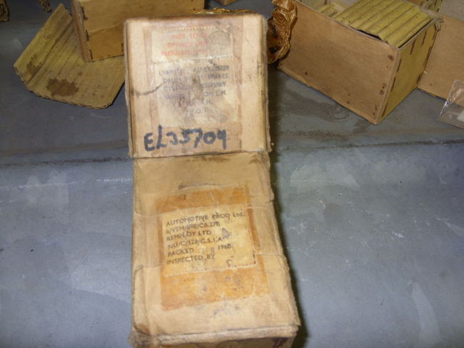

hi
i have found 5 new one`s in the box in Holland
see the link for the manual look at picture 366
http://www.northwestclassic.co.uk/LOCKH ... NWARDS.pdf" onclick="window.open(this.href);return false;
the part numbers at the Volvo manual are also the Lockheed numbers
Northwest classics has also all seals for it
only Volvo has the felt ring at the pistons i do a O ring at the piston
they are not made in the USA it are AP Lockheed cylinders from England

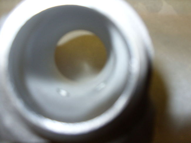

my 8 old cylinders are repaired a 1/4 mm out and a 1/4 mm hard chrome in
i will take picture`s of it as go to my shop today

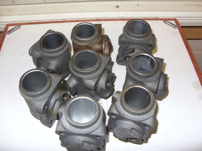

hi
i have made the picture`s from my cylinders
below the hard chrome one`s
the new one`s
the cylinders are used on a
Austin 1 ton 4x4 rhd
and two types of British made Dodge see at dodge the 3 and 6 on the list below
http://www.northwestclassic.co.uk/LOCKH ... OL%202.pdf" onclick="window.open(this.href);return false;
George
